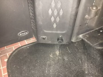

Hey Ken. Glad you got the unit going. I just had my blower out yesterday while dealing with another issue. Seemed a good time to clean the blower out. As far as that switch goes: when it is centered, it is off; when flipped off towards the front, the fan is always on but I am still able to control fan Speed; and when flipped off towards the back the fan only kicks on once the stove reaches a certain temp (somewhere around 150-200 degrees), which is the setting shown in the pic I have attached. The description you gave in a prior post sounds like we have the same set up. On the plus side of things my living room is at 78*, while it is 8* outside, and my stove is running at an easy 425*! This is a direct result of getting the blower cleaned out. Life is good right now. Best of luck with the stove!
[Hearth.com] Enviro Kodiak 1700 fpi shroud replacement experience
Thanks for replying, and appreciate the assistance. the picture you provided is the new left shroud I have now, the original does not have the vents you see on the left side and other changes I mentioned previously. I have it cranking now. Best
