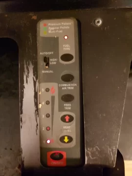

I press the power button like I normally do and usually the fans keep going and agitator starts spinning but today I went to turn it off and the light that indicates your fuel type switches from red to yellow and back and back to red and it immediately turns back on again and multiple tries and same result. Also the fans stop for that split second and the agitator doesn't move. Anyone know what could be going on?

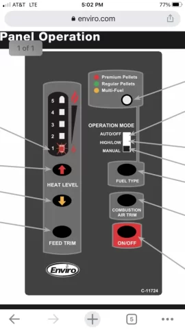

I run it in the auto mode on premium pellets. I have no clue where tsat connection is...I assume its thermostat but mine doesn't have anything on it that says that on it
Ok is this your board? Auto mode requires a thermostat

I've always had the switch all the way up. I've replaced the combustion fan, auger motor and the convection blower but never encountered the problem its having now. I called the place we bought it from 10 years ago and they have never heard of this happening
Put the slide switch to manual. And try the stove. Manual mode bypasses the tstat circuit. Someone put a jumper on the thermostat connection or it wouldn’t run in auto.
