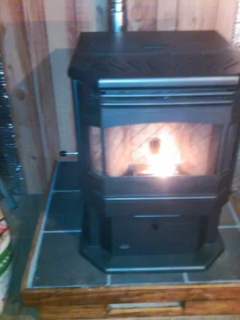

Well I had the chance to pick this Meridian up and when I first saw it all dusty and dirty but working good, I fell for it!
Finding the Manufacturer's so called Perl Gray touch up color paint was my first stumbling block. After quite a few days, I found some good fresh "Stove Bright" Charcoal color that matched Perfectly!
See > https://www.hearth.com/talk/threads...ray-paint-at-a-good-price.86502/#post-1116809 It is a very good color!
I had to order a new cleaning rod because the original was missing. That will take a while to get!
Now that I know there is no lock washer in the design, it probably came unscrewed and was lost!

Thanks for the info. I like the auto-on/off because I can turn the stove on in the shed from the toggle switch in the house. I can then shut it down manually by pressing off so that will not be too bad.
The heat can really fade the paint after 3 or more years, depends on the environment to. I gave our Meridian the paint job from head to toe with 2 cans of the Stove Bright Charcoal and now it looks brand spanking new!
