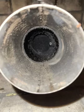

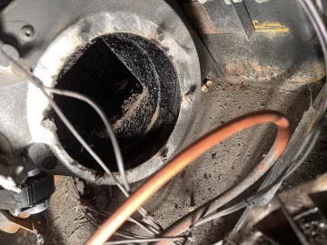

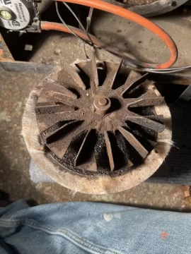

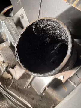

Thanks for the quick response. I pulled the stove and I’m going to order a new combustion blower. After removing the stove I notice a lot of build up on the chimney liner and within the fan. Is this all stemming from the same problem. I did a deep clean and everything was full of soot and ash. Just want to know if there is any other possible issue before I put it all back together. Thanks!

In the parts dig. Remove number 30 and
clean behind it also clean from there the
passage to the blower around the slider plate
This type of cleaning should be done at the end
of every burning season and when necessary
A clean stove is a happy stove
