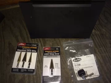

So what about the ash pan?
Dollar bill test will never pass! The ash pan is hooked in on the bottom left and right corners so it shuts using gravity. However the ash pan gasket does not compress enough to make a tight seal!
Where is the ash pan latch? Only the Mini-A has one but the latch itself can be purchases for about $45.00 and it is a good heavy solid one. :-)
The only other thing you need is a big hole! Since the hole required is approx 13/16" and most metal drill bit sets go up to 1/2" that can be a problem!
However the new Titanium Step Drill bits can easily solve the problem! I got some from Harbor freight!
See pics. Now the ash pan is latched up tight!.
Just find the center of the pan and measure approx 1-1/2" down fromm the top.
Pic 1 - Where's the latch?
Pic 2 - Titanium step drill bits
Pic 3 - New Ash Pan Gasket but not tight without a latch!
Pic 4 - Drill a hole with a regular titanium bit to start
Pic 5 - Now for some stepping up to the big one
Pic 6 - New latch
Pic 7 - There is the latch! LOL
