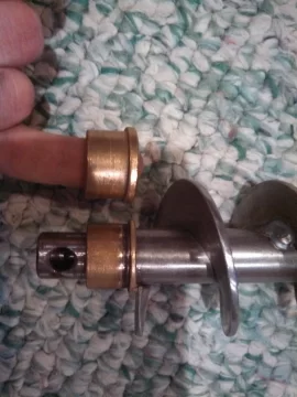

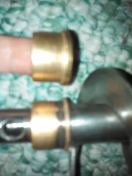

I purchased a plate/bushing assembly in July 2012. I only run the stove during the winter so that assembly lasted me only one heating season before it caused the gear box failure. I purchased the stove in August 2009 so that fall/winter was the first season. The factory assembly only lasted 3 years. I luckily had purchased spare bushings last time when I had the issue so I was able to get the bushing in the plate and get the stove back running once I fixed a gear box. The top bushing is fine as there is no pressure or force on it like the lower bushing. I have uploaded a couple pictures of the wear. All seems flat and balanced. I would think that in the manuals it would say to check the bushing for wear in its maintenance schedule if they knew of the wearing problem.
Wow that's a lot of wear.
The shaft is either bent or too big for the assembly or something is throwing it out of place somewhere along the holding chamber. When you place the new bushing on the lower end, does it turn freely?

From the looks of the bushing it was turning in the plate
The auger should turn in the bushing . Check to see if the
auger is bent it does not have to be bent much to make the
bushing jam and turn in the plate.
The bushing did seize on the shaft and it was turning in the plate. If it is bent, I cannot find it.
Try using some silicone grease on the shaft inside the bushing
just enough to make it slippery. Thats what I use . I do mine every year at it's
full spring cleaning ( both bushings) and never had a problem with bushings
or auger 1n 12 years .

They are sintered bronze bushings, grease-impregnated. That means there are tiny "pockets" of lube in the bushing material itself, that releases over time, to lubricate.
Theoretically, adding grease to this type of material can block the pores and not allow its own grease to surface and lubricate, but I have not seen this happen.
Synthetic grease usually has more resistance to high temps.
Something is causing the lower bushing to seize on the auger shaft which forces the bushing to rotate in the end plate. The bushing should be a tight press fit in the end plate, not able to rotate. When installed, the auger shaft should be able to spin somewhat easily inside the mounted bushing. What does the surface of the auger shaft look like, where it spins inside the bushing? It should be smooth, round, and polished, no burrs or galling allowed.
