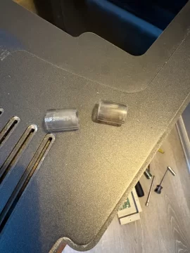

They are (were) both there. I've removed them and will try to find something that offers more damping, and perhaps wider too, so as to have less back-and-forth movement. I'm going to the local wood stove specialty shop today to look for a couple of things (they also sell a few pellet stoves) and will see if they have any suggestions.
Unfortunately, with my limited tools, I don't think I'll be able to actually remove the auger. So, I'll just try messing with these bumpers and see if that increases the quietude...

Yes, our Mini does that too. Anyways, I have put an additional layer of silicone tubing underneath that hard plastic bumper, and if that doesn't help, I've got a few other ideas. I'll post an update when I get it figured out...

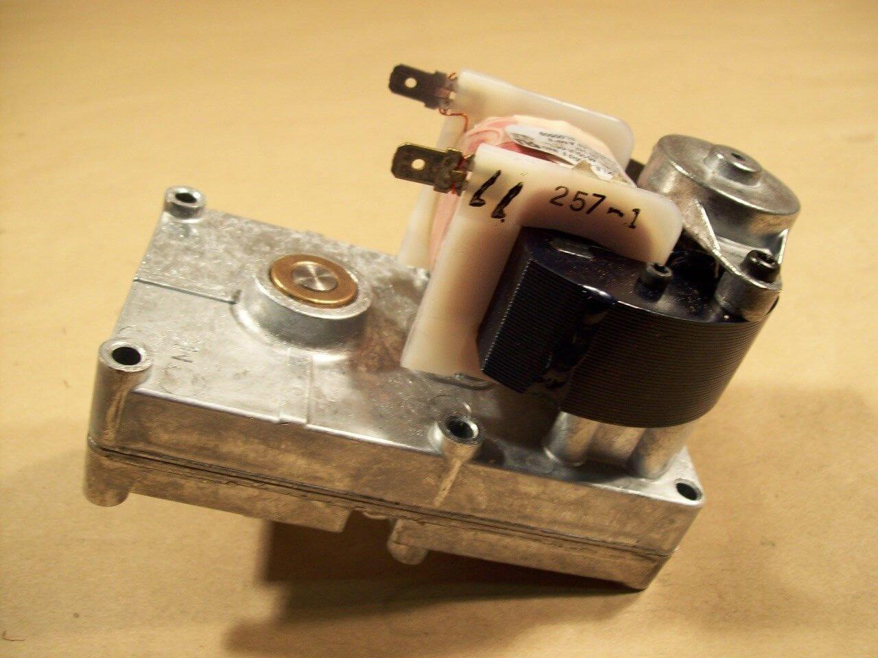

I'd thought that the bumpers were the problem, but nothing I tried seemed to help. It now looks to me like the metal piece that moves up when the motor engages (see the video below) is the ultimate source of the noise. Is this normal? If so, is there anything that can be done to dampen the noise?
That looks like the lower bushing on the gearbox is stuck to the output shaft
and worn the gearbox housing. If the bushing and shaft are seized together,
The only repair is to replace the auger motor or have a machine shop replace
the bushing with an oversize one that is press fit to the gearbox

Thanks for the quick reply. I'll replace the auger motor then, and report back after it's done...
I replaced the auger motor with this one:
It's now so quiet that I didn't even realize it was working until pellets started dropping. What an amazing difference--better than new!
