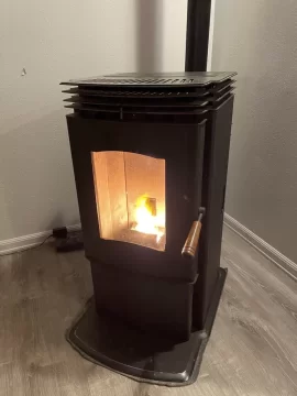

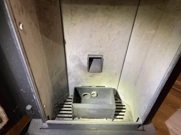

I got the parts and installed them today. It was literally a 10 minute job, and everything seems to be working fine. If I notice any problems later, I'll post here.
The new burn pot took a little persuasion (with a hammer) to get it positioned properly, but otherwise it was all trivially easy. In our version, there was a slider under the (open) burn pot, but the Mini-A has an enclosed burn pot, so that slider has to go--I just bent the handle slightly to remove it, and if need be, I could put it back in place (there is a small hole where the handle for that slider exited that I'll need to plug). There are a couple of tabs on the Mini-A burn pot that align perfectly with the grate, so it was obvious when it was positioned correctly.
The first picture is our Mini setup before the swap, 2nd shows the old and new parts, the 3rd shows the new burn pot installed, the 4th is the new burn pot with the burn pot liner inserted, 5th shows the slider thing I mentioned above, and the last one is the payoff...

Just a quick update: So far, so great!
This is definitely an upgrade to the original Mini, and I would strongly recommend it to one who bought the Mini before it became the Mini-A. The benefits to this Mini-A upgrade include
1) More consistent ignition
2) Far less crud building up on the glass
3) More heat
With the original Mini, starting the fire usually worked, but it was always iffy, with the fire either failing to start or dying (by getting smothered by pellets) a significant percentage of the time. With the larger burn pot, this issue seems to have completely vanished, as it starts much more easily. Previously, the glass would start to foul almost immediately, and after a few days of light usage, it would need cleaning. With the Mini-A setup, the air circulation across the glass is vastly improved, and the buildup is far, far, far less. And, yes, the Mini-A mod does even seem to put out slightly more heat on the same setting (I have not tinkered with the pellet feed rate). Heat-wise, I'd say it is at least 10% more at a give setting.
We've had this mod for 11 months, and here is another quick update...
Everything continues to work well. If anybody out there is still running an ancient Enviro Mini (pre-Mini-A), I strongly recommend this simple mod, as it is a definite upgrade.
