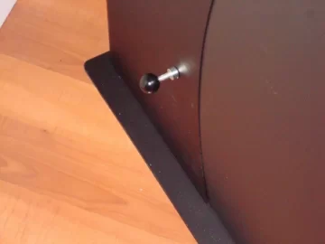

The installers really didnt supply much info on the stove. First one they installed that was a omega. They told me not to touch the feed trim because they would have to come back to program it. So that made me afraid of installing a thermostat. Also if its on a thermostat i was worried about the air trim.

They opened the air all the way and told me to test different settings. They told me if you have it on low pull the trim out a inch. If you have it on medium put it to half. If you have it on high open it all the way. So right now i have it on 1 out of 5 and the air trim out alittle and the flame is kind of low
The installer left and the air trim was wide open because it needed to run on 5 out of 5 for an hour to burn out the oils. I turn the stove off after the smoke cleared. Now my problem is IM A NEWB.

THE SLIDER / DAMPER MUST BE SET AT TIME OF INSTALLATION. A Qualified Service Technician or Installer must set the Slider Damper.
If the fire should happen to go out and the heat output indicator has been set on the lowest setting, the Slider Damper should be pushed in slightly, decreasing the air in the firebox.
If, after long periods of burning, the fire builds up and overflows the burn pot or there is a build up of clinkers, this would be a sign that the fuel quality is poor, this requires more primary air, the slider damper must be pulled out to compensate. Pulling the slider damper out gives the fire more air.
The easiest way to make sure that an efficient flame is achieved is to understand the characteristics of the
the fire.
• A tall, lazy flame with dark orange tips requires more air – Open slider (pull out) slightly.
• A short, brisk flame, like a blowtorch, has too much air – Close slider (push in) slightly.
• If the flame is in the middle of these two characteristics with a bright yellow/orange, active flame with no black tips then the air is set for proper operation, refer to Figure 7.

IMPORTANT: Taking a reading of vacuum pressure inside the firebox with a magnehelic gauge should be used to set the slider for best combustion.
The slider damper should be set only on a hot stove (operating for thirty (30) minutes or more) by using a Magnahelic Pressure Gauge to measuring the pressure in the firebox.
The best settings are a reading of approximately 0.12 - 0.15 inches of water column (29.9 - 37.3 Pa) on the high fire setting. Some fuels may require higher or lower settings. The reading can be taken from the 1⁄8” (3 mm) hole located on the front of the unit below the ash shelf on the right hand side.
</end>
see it shows you set the damper at the High setting with a pressure gage and LEAVE IT.
I know with my stove Out the wall and up 12 feet at 3000 foot elevation
I had to have my air rod pulled out a little more than 1/2 way to get the 0.13 reading I wanted on high.
when you turn the feed rate down the control board lowers the voltage to the blower and the vacuum reading will go down adjusting for less fuel in the burn pot.
I cant believe your installers did not Adjust this for you.

Pull the air out about half way
If you glass black then you need more air pull it out more.
Grey build up on the out side edges on the glass is normal.
You dont want black.
