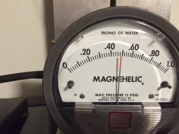

Test port as lake girl said. In your manual you will see there is a recommend setting for the draft in the stove. There is s gauge for measuring this and hopefully it was set correctly when the stove was installed. If youf stove has a good active flame and is burning clean then there's nothing to worry about. Attached is a pic of the draft gauge
Thanks very much folks! Makes perfect sense now....yep my flame is perfect. Much appreciated!
