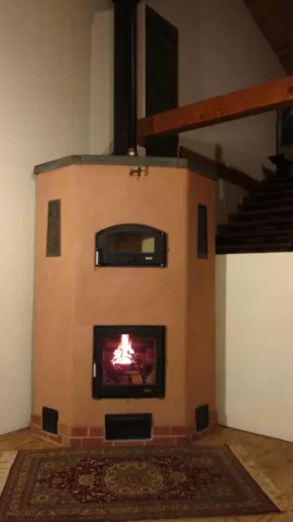

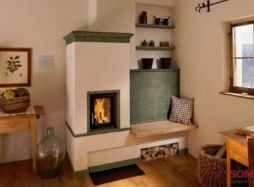

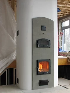

Yes this is the ultimate option as a masonry heater will do 90% of your heating if you have supply of wood. Finding a mason with experience can be a challenge in some area but these truly are not only functional but beautiful as you can choose your finish, eg stone, brick, tile, etc. They come at a price though
If you want a look like you describe, there are some very cool Swedish woodstoves out there as well.
Corner masonry heaters.

Wow, those are really cool. It just so happens that I fully intend to have a pizza oven in the future (though not sure if I'd do this in the living room), but not sure if that quite gets to the temps I would need, maybe? Unfortunately, I don't think that this will be an option as masonry is likely out of the budget, but will definitely take it into greater consideration.
I wonder if this is something I could consider for the basement in the future? I could definitely see needing to incorporate it into the initial design of the house.
It looks like a lot is included at a fair purchase price, budget wise my concern would be more for required non-combustibles surrounding it.

It just so happens that one of our close contacts is a great mason, but unfortunately masonry is probably out of the budget for this. Will definitely consider though, and could be a great addition to the basement later on. With this my only real concern is that I would primarily want it for the pizza oven, which may not get hot enough. lol, but looks like a very efficient way of heating. I anticipate having a decent quantity of wood after necessary clearings on the lot, but won't have a steady source afterwards. So not relying on wood heat yet.

We had a masonry heater….I miss her so. We actively used the oven above and it plenty hot to cook pizza, casseroles, pies, etc. No problem at all and it was in our living room but it was an open concept house and the kitchen island was like 6ft away. Can’t say enough about these to be honest as one fire in the morning kept a 1600sq ft house warm all day on most days in the winter. When it was really cold, a second fire at night and we barely used any propane in that house which fueled the central air. Now that house was built with SIP’s, triple pane fiberglass windows and r60 cellulose blown into the attic/ceiling. It was a single story craftsman style ranch and was thought to be somewhere we would live long term but that changed a long time ago. This was in zone 4a if I recall correctly.

Very cool. I have no doubt that it can cook a good, specific style of pizza, but for me (at least until I can add something like this to the basement for heating purposes), the pizza oven feature would be, though silly, the primary draw for me to this at this point. I haven't yet made homemade pizza, but have family and friends that do. I think this would be unwise for me to purchase primarily as a pizza oven, being that the oven ceiling to floor temp ratio theory and the lack of potential upper range pizza cooking temperatures doesn't make it quite as flexible as a standard pizza oven. Though, I still really like this and would definitely use it for certain types of pizza and other cooking/baking.
