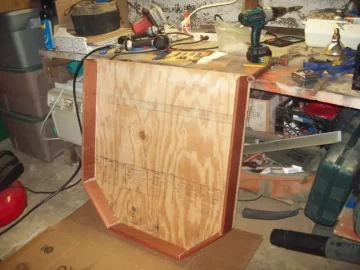

Thanks brother, I can't wait to be able to put up some pics. I started the hearth pad today, which meant setting up my tools in the new basement. It took quite a bit of time just to lay out the pyro-guard plywood with the tyle to make sure the corner angles are going to work out perfectly, the hearth pad will look very similar to the one on the Enviro Empress flyer. With some minor differences. I started the base of the pad as well after cutting out the plywood. The bottom of the platform pad will have 1x4 makore (african cherry like wood.) I started to put it on today. Installing the pipes will be easier than the building of the pad. It'll be a joy to light it up for the first time.

Ok, so here's what I've got so far. The pyro-guard plywood is 3'x3' with cut outs in the front corners. The base is Makore. On top is Durock. The sandstone 12x12" tyle is almost all cut and dry-fit on top of the pad. The second member of the trim is just a temporary form like piece. After I mortar in the tyle and it dries, I'll wrap it in the Makore and add a nosing to the whole edge. It was actually pretty fun setting up the tools in the new house. I'm taking my time with it and trying to enjoy this time spent making something that'll last for years to come. Today was a full day, we went to a farm to get the boys some pumpkins and had a halloween hayride party from 6:30-8:30 this evening. You gotta love fall! Here are some pics!
I even had someone on firewatch for this project! :lol:

Cute little fellow!
I haven't seen pyro-guard plywood so I am learning something too! Looking good so far!

Thanks J,
The pad will be very heavy when finished and I'm hoping will last a long time! Pyro-guard is usually used in commercial construction, we deal with it a lot. My father-n-law grabbed this 1/2 sheet of 3/4 from his job, seeing as I'm laid off now. As well as the 2" EMT from the electricians and some sheetrock I'm using to block off the pipe inside the closet. It's one of the benefits of being a carpenter, sometimes it works against you, you just have to learn not to hoard material. :lol:
