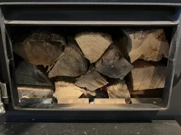

Here are some pictures of one of our burns over about a 25min time period. The stove was set about 3/4 of the way open. Do these temps look ok?

I turned it up after this wide open and let it go for a bit, until I felt like it was getting a bit uncomfortably hot... I know BK did away with the numbers on the sweep, so I don't really know what to reference to make sure I'm within safe parameters. I'm assuming it's not good to let the gauge sweep all the way clockwise around back into the in-active zone, right?

Last night we burned it really hot for a while, we had stove top temps around 600*F and flue temps (at about 3' high) around 300*F. We did just clean the chimney about 2wks ago. We used the stove occasionally last winter while we were here working on the house or staying a couple of nights before me moved full time. This year we started burning in October, but not full time... lots of smaller shorter fires. The weather has been weird this year, so we haven't been burning 24/7 yet, maybe a couple days straight at a time. The flue was impressively clean when we cleaned it (at least I think it was, judging by a lot of pictures I've seen on here, but again... this is our first experience).

I haven't stuffed it to the fullest, honestly. I've always leaned on the side of caution (foolishly) thinking that it would just burn hotter, not really understanding the full function of the cat and thermostat... the past couple of days I've finally started to load it heavier. Last night was about 14hrs and that wasn't even trying that hard (my splits could be smaller... some of the logs I had were 3' in diameter, so there's quite a bit of wasted space due to my laziness during splitting).
Nice. The thermostat will basically function as a "dosing device", spreading out fuel usage (wood load) over an amount of time. Fill that tank and you'll burn longer (at the same thermostat setting).
Large splits are good for longer burns. Splits that are too small will burn up faster.
But indeed if you end up with a lot of empty space, you get less BTUs put into the box.
I suggest a mix of large and smaller splits.
And then play stove tetris :cool:
Another question I didn't think about until now; when doing a Tetris full-load, how big are the logs you're loading? Is it better to have a bunch of smaller ones?
A mix is best. I start with big ones. Preferably square or rectangular once. And then at the top I end up needing some smaller pieces.
If I have triangular splits, I do need some smaller ones halfway up as well.
See it as concrete: large gravel, small gravel to fill the holes, sand to fill the leftover holes, and cement to bind to the sand.
BUt you can take it too far; it's a bit of a hobby of me to stuff it. Not always success ful though.
There's a "whats in your stove right now" thread with many pics of many folks. Have a look. Not everybody plays tetris, and those who do don't do it always.
In the end, if your life works best with a 12 hr reload schedule, then who cares if you don't tetris and get 14 hrs already.
From what I'm understanding now, it may be better to do a bunch of small guys instead of larger ones because of, from what I'm reading, when a log breaks and all that surface is exposed, the off-gassing may be too much for the cat. So, is it better to just split everything into smaller pieces to 1) avoid over-gassing the cat and 2) make it easier to fully load?
No, smaller ones means more surface area per lbs of wood, so more offgassing.

Here’s my princess reload from a couple days ago. These are smaller splits, but in general it should take about 10 splits to fill it up.
  • [Hearth.com] First time wood-stover... BK PE32; am I doing it right?
Here is the what's in my stove.
