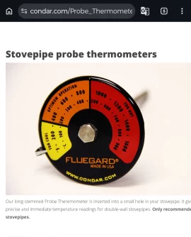

Those are valid concerns for an Auber probe. (As is cost)
Hence I have this
Hence I have this
I have the same. Works well to make sure not to let the flue temperature get too high on startup and as an indicator on when the stove is ready to be turned down and for the bypass to be closed.

Ditto all the comments above. I have the condar flue probe, i think they're like $15. Drill a quick hole in the front of the double wall, and it's great to have. On these Ashfords a stove top temp gauge is pretty much useless, because of the cast iron jacket around the stove, so i like having the Flue probe as a second data point to the Cat temp gauge. I also definitely close bypass before cat gauge is fully active. I usually do cold starts with just newspaper and super dry kindling, if i don't close the bypass when the flue probe is at 400/500 i get flames shooting right through the bypass up the stove pipe - makes me nervous. The cat always kicks right off since my kindling is so dry and the flue gasses are already approaching 500.

I use the probe meter a lot. I have a mechanical condar in the house BK stove and a digital auber in the shop noncat stove. Both work well but the auber is more responsive. The condar looks better and has been very dependable.
There is a lot of value in being able to read these meters from a distance. Like on the couch, I can see that everything is proper at a glance.
