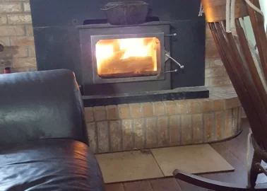

Previous wood burner exp is with an old smoke dragon Heritage insert (it was huge!) from 1982. It was a great instead for it's age. Easy to light, burned hot when you needed, but it was a pig for wood. Sub 8hr burn time on a full box of dry oak. Airflow was primitive as was the external blower ...
