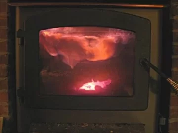

Until one has experienced secondary burn they have not experienced wood burning.
You know it is similar to the northern lights on a cold snowy night huh? I also like having a fire during the day without dumping smoke down the street, but even an EPA stove can do that if you don't pay attention.
