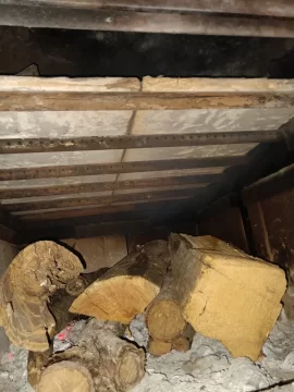

@bholler I admit defeat on the baffle idea. We are doing a small fire tonight and with my genius mower blade baffles alot of heat was going up the chimney. Original baffle back in. Gonna buy another cut to fit ceramic fiber board to put on top and extend forward a bit to slow it down more. Still dead set on the "smoke dragon" conversion for now. There is no air to secondary tubes and she's running nice and steady. A much more controllable burn I have a feeling I will get some long long burntimes like this but time will tell when the cold weather comes.

@brenndatomu the ceramic board baffles are back in.
