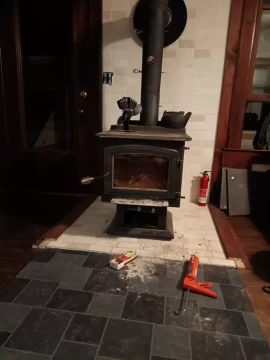

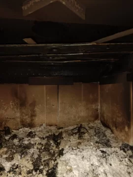

Long story short. Our main heat is a vogelzang 3200. We used it from December through spring last winter. Constantly fought overfires almost melted the top. This stove is horribly designed to an unsafe level to meet emissions. This year I am gonna take matters into my own hands. I have found all the hidden unregulated air inlets on this stove and blocked them off. I have removed secondary tubes and the insulation baffle above. So now shes just an old school smoke dragon with a glass door. Did a little test run last night looks to be promising. Has stt of 520 and ext. Flue pipe temp of 270. This was with both air intakes open. As temps drop I expect similar with intakes closed. Let the bashing of my idea begin.

Sounds like the symptoms were treated without understanding the causes of the problem.

I would at least stick the baffle back in to get a little more efficiency and cleaner burn.

Yup, put the tubes and baffle back in...all you need to do is restrict the secondary and maybe the primary air to accomplish your goal...well, make sure the chimney draft isn't too high first...but if its ok then just start experimenting with how much things need to be restricted off to make it burnt controllably.

A common problem with folks burning in a modern stove for the first time is not shutting down the air soon enough. There can be a sudden outgassing (bloom) of wood gases if the air is not controlled well. This can be substantial if the splits are small and can lead to an overfire. Closing off the boost air ports in some cases does help but removing the secondary burn is like tossing out the baby with the bathwater.

@Todd @brenndatomu this is still in the experimental phase. The way I have it now 0 air gets to secondary tubes. I very well might stick them back in, with the baffles to slow down the smoke. I do have 3 dampers in my pipe ( that's how outa controll this vg3200 gets in factory form). I'm also toying with the idea of a thick steel baffle on top of tubes instead of the roxwool??? One from factory

I would put the tubes and baffle back and try it with just the air inlets blocked. Definitely put back the baffle, it's not making your stove go out of control, if anything the stove is more likely to go out of control without it.
Even smoke dragons had baffles (the better ones anyways)
There is no advantage to having a steel baffle IMO...other than durability, if you are one of those people that just chucks wood into the stove, instead of stacking.

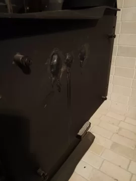

Towards the end of last season I did have it running good, but the holes on the side of the stove underneath the jacket started to smoke a lot. With a new baby in the house I don't want smoke pouring into the house like it was at the end of last season

Yes, I was concerned about using silicone in those hot areas. It is only rated at 400-500º. A metal patch would be better.

It's not the silicon. It's the location of the holes drilled into the sides, before the secondary would take off it would puke smoke out until it got up to temp
Just a guess. This might be the three dampers restricting draft enough even when open. Once the chimney warms up, the draft is stronger.

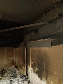

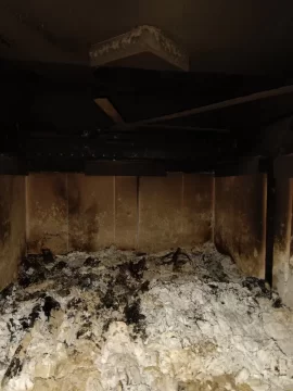

yall are gonna laugh, but I own a mowing company and work for another landscaper as well so dead beat up mower blades are easy to come by. The 20.5" blades (for 60" mower you use 3) fit perfectly. Gonna put some more in there and try as a baffle.

View attachment 315401yall are gonna laugh, but I own a mowing company and work for another landscaper as well so dead beat up mower blades are easy to come by. The 20.5" blades (for 60" mower you use 3) fit perfectly. Gonna put some more in there and try as a baffle.
That might be the most Red Green thing I've ever seen on Hearth.com! ;lol
Nice looking family there.
I think those blades are going to sag without being bolted to a stiffener.

It’s the cooling effect of the secondary air that keeps the tubes from sagging and the SS alloy.
