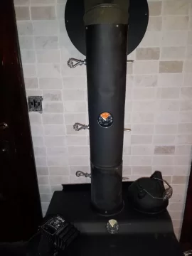

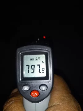

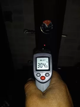

Everything shutdown and she's back to running hot again. This is in 50f weather too.
Guess i need to block some air intakes again. Smoke checked everything again tonight and no leaks found. I'm really starting to hate this stove lol

You’ve probably already posted about this but how tall is the chimney?
Vg3200p
Nov 21, 2021
508
Clinton county indiana
Over all around 25ft never actually measured but I installed it. Bout 5 5ft of single wall into roughly 20ft of Selkirk class a
Ctwoodtick
Jun 5, 2015
1,841
Southeast CT
Not incredibly tall. Is the stove itself leaky?
Vg3200p
Nov 21, 2021
508
Had this stove for just over a week. Old stove same brand just way smaller. Never came close to overfire and I dint have any dampers on the flue with that one. I have experimented with blocking intakes dampers and smoke tested new stove every night tgat I've owned it. Never have found an air leak. Before I installed dampers it had a true overfire that warped stovetop

That 797 is with the air shut all the way down and 3 key dampers shut? Holy mackerel! That stove is really poorly designed and/or has a failure somewhere. That is a ridiculous number in a 25' chimney.
Sorry you have to deal with all this. You'll need to make it work for now as you said but I'd strongly consider going to a different stove this off season.
Vg3200p
Nov 21, 2021
508
That's with everything shut for probably an hour. The stove runs really mellow for a long time then at some point every burn it just goes crazy for an hour or 2 then goes back to mellow. I might just need to load this thing like 1/2 or 3/4 capacity to make it safe. But kinda defeats the purpose of a 3+ cubic ft firebox
