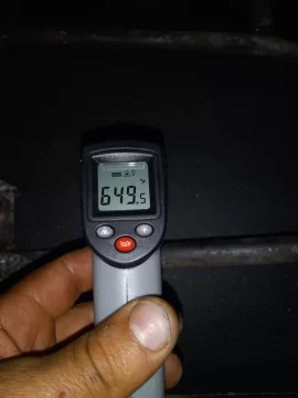

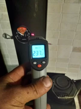

Ok so mild night tonight. 40f. Blocked off 3 of the six holes hidden underneath jacket. Overall i have probably blocked of 80% of air that this stove could breath in its (low burn) setting. I truly don't know how they didn't literally melt the stoves when they tested this design. Stove is running exactly how I want now finally. I have primary open maybe 10% to keep flue temps up right now. So when it gets real cold again it should be about perfect with primary all the way closed. I still have the dampers just in case. Stt at 630 flue surface at 235 nice lazy secondaries.

Keep in mind when flue temps get below 250 creosote will form in the chimney. Especially if the wood isn’t dry enough.

If that 235* pipe temp is external (and I think it is) then it's fine

This is single wall surface temp. At 18" so interior is probably 300 to 500f I've always heard 30 to 50% higher than surface reading

At 235* on singlewall surface you are probably 475* ish internal...that'll do...

I ran the loads last night and tonight with the jackets off. Ran great. Put the jackets back on and I think it made the remaining open holes draft harder. It wasn't running away but hotter than what I would like with full air shutdown. So I covered a 4th hole partway into tonight's burn. She seems to run really well there. One good thing about this stove is that it always makes pretty secondaries that last a long long time. Dampers all the way open tonight. I suspect when really cold weather returns she'll be running with 1 closed but that's ok. 20230117_191532.jpg 20230117_191537.jpg
