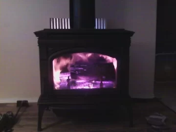

Have you given any thought to a freestanding stove with a huge glass to view the fire? A lot of stoves have a big glass that stays pretty clean, even when it;s burning slow. I couldn't be happier with my view!
