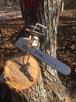

Had an equipment failure today, not nearly as fun as Janet Jackson's, but my saw chain came loose from the bar while cutting. It's the first time it happened to me and hopefully the last. I was disappointed in myself for not noticing it was that loose, but I'm guessing it was caused in part by getting my saw pinched a couple times. It must have stretched the chain a little too much.

That on occasion does happen, or a link breaks. Also I have once or twice put the chain on backwards.
Polish chain saw............ :p
  • Haha
Reactions: MoDoug
I had my chain on backwards once, wondered why it wasn't throwing chips, fortunately my neighbor happened by and solved my problem. I felt silly, but a lot of life's learnings are dumb chit moments. LOL
i had that happen to me but the difference was the bar was worn more on one side but enough to make it keep happening
Reactions: MoDoug
It happened to me once, but I didn't tighten the bar nuts enough and they loosened up over ten minutes of cutting. This was when I first started using chainsaws.
Reactions: MoDoug

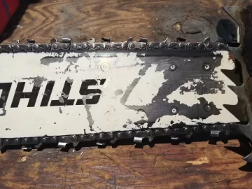

Like this?
I was told the induction hardening process for manufacturing bars causes the bluing heat effected zone. Thought someone would comment on that. Anyway, it threw me first time I saw it - thought I fried another bar - but apparently, nope, just that I finally used the bar enough to wear off the paint. Unless you're seeing something different.
Other than that, it's pretty rare that I throw a chain off the bar. Never broke a link either. I have ppe on generally, so any damage from flailing chains should be reduced.
...hardening process for manufacturing bars causes the bluing...
Exactly what he said.
The blue is on every bar, under the paint.
If that blue was caused by you, you'd know it from the huge plumes of smoke coming of the bar while you're cutting.
A friend of mine’s brother made a butcher knife out of old chainsaw bars where they twist he steel, Damascus I think it’s called? It was super cool looking and I wanted one but couldn’t afford one at the time. Not sure how good of a knife it made but it sure seemed like it might be good
Induction hardened bars will show an 'even' blue shade the length of the rail. Localized overheating from friction (lack of bar oil) will show as spot coloring with shiny sections. Other way is discolored paint near the rail and mushrooming the the edge of the rail from excessive friction.
