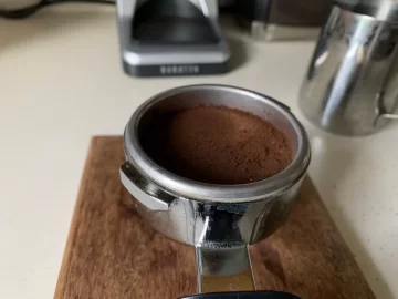

Okay, things I changed:
1. My usual beans came in, so I was able to switch back to those. Yesterday's experiments were with a substitute bean from the same roaster, but not the usual bean, as I had run out.
2. I ground into a small frothing pitcher, as it was easier to get an accurate grounds weight from this. Then I'd pour into the portafilter, tap, and tamp, before loading into the machine.
3. Thoroughly rinsing portafilter with hot water between each run.
I started at 13E, where I had previously left off with this particular bean, and metered 0.56 oz. (16g) into the portafilter. After leveling (tapping techinique) and tamping, it looked like this:
[Hearth.com] Espresso machine

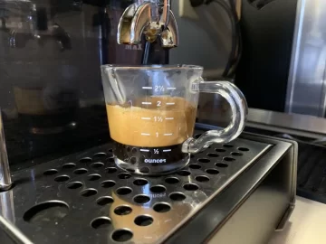

I pulled a 2 fl.oz. shot in 25 seconds, and weighed it at 1.265 oz., or 2.26:1 ratio. Here it is, after just a few seconds settling, but it appears to be all heart and crema, little body:
Ironically, if I had stopped at 22 seconds, as I had been doing yesterday, it would have been a perfect 2:1 at 1.10 oz.

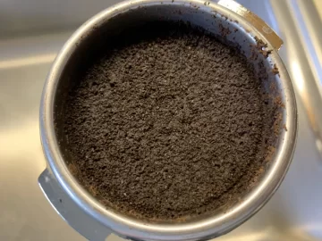

After the shot, my puck looked like this:
I pulled four more shots, and although I find liquid volume measure (fl.oz.) to be horribly inaccurate, they were all hitting 2:1 between 21.5 seconds and 22.6 seconds.

Puck isn’t wet, just damp. It came out whole.

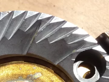

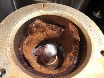

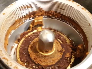

Soooo, if you guys are still hanging out here, I've been having some issues with my Rocky grinder lately. I haven't been able to grind quite fine enough and haven't been cleaning the grinder properly(read=AT ALL). This is what I discovered...
It looks like an Italian sculpture!

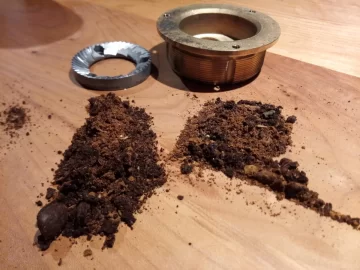

...and this is what came out of there.

Looks like the cutting edges are off the burrs as well. I've ordered a new set and I'm treating myself to a naked portafilter.
Even after cleaning everything up, still can't get a fine grind.

Unfortunately, I’m not much help with the grinder calibration. I don‘t own a Rocky, and both of my burr grinders are still new enough that I haven’t had to do any maintenance on either of them. But I do know they need to be recalibrated after changing burrs, so do you think it could be as simple as that? I just did a quick YouTube search on Rocky grinder calibration, and this was the first hit:
Yeah, did the cal when I reassembled, still no joy.
Your earlier post wasn’t quite clear, when you said, “Even after cleaning everything up, still can't get a fine grind.” Are the new burrs installed, or are you still waiting to receive them?
Still waiting, they'll be here next week. Took it apart again last night and noticed that the bottom burr runs a bit eccentric when spinning. Unfortunately Rancilio doesn't index the burr to the carrier and with the bit of slop around the screw holes it's difficult to center it perfectly. May try using flat head screws instead of pan heads, using the taper of the head to center the burr, assuming the PCD is concentric to the motor shaft!

Portafilter and burrs came today. The old burrs were the problem, new ones are able to grind finer than flour and choked the grinder! Roasted 1/2 pound of fresh coffee this afternoon and used most of it trying to dial my shots in. It needs work...will have to continue experimenting tomorrow, can't drink any more coffee tonight.
