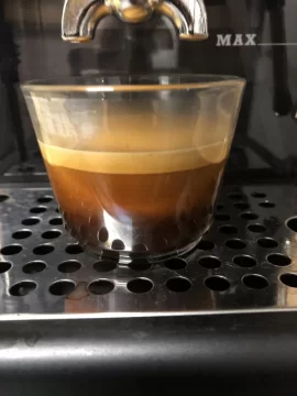

Well, here is my "review" of the Sette 30 grinder, FWIW.
1. It is a well built machine, not too heavy, not too light.
2. It is not as loud as I have read in reviews on the interwebs.
3. The instruction sheet mentions to use a setting between 7 and 10 for espresso.
4. I have been playing with settings from 11 to 15; conclusion 11 is the absolute best for the Gaggia Classic Pro. Everything lower than 11 chokes the Gaggia.
5. It takes 4.2 seconds to grind 18 grams beans. My beans are Costa Rica and home roasted medium dark, not even close to French roast.
6. The grind setting will depend on the type bean used and how dark they have been roasted.
7. With a firm tamp (non calibrated) it takes the Gaggia 26 seconds to pour a 2 ounce espresso, see picture. Pretty good IMO.
8. For now I see no need for the micro setting ring. Maybe when I ever upgrade to a $1,500 espresso machine, but that is very unlikely.
9. Excellent investment.
10. I will post more after the bottomless portafilter has arrived.

Nice. Not sure I follow your #4, though. Usually pressurized portafilters are aimed at letting you use a coarser grind.
On the grind setting, I’ve seen that Baratza is just all over the map. I am also operating my Virtuoso nowhere near their recommended starting point, to hit my 22 second shot times. They must not have a very consistent way of calibrating these at the factory.
My issue with the Virtuoso, and it’s aforementioned fairly large step sizes, is that some beans require a grind that’s between two settings. The step size on the Sette is almost half that of the Virtuoso, so maybe you’ll find a setting close enough, with any bean.
Nice. Not sure I follow your #4, though. Usually pressurized portafilters are aimed at letting you use a coarser grind, not finer.
You're correct, ignore comment 4. Comment 4 edited.

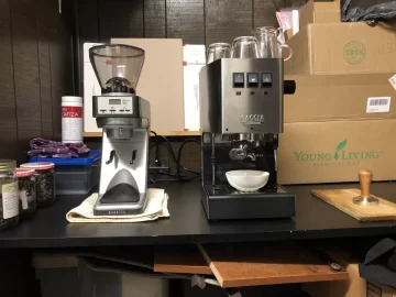

Getting a bit crowded, may need to rearrange.

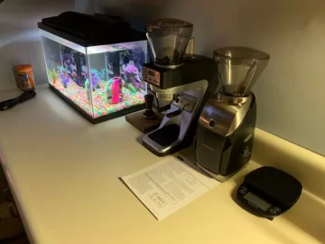

Gave it a whirl this morning. Jammed the espresso machine several times, working up from Baratza’s recommended starting point (9E) to something close to my correct shot timing (15F, or something close to that, can’t remember now).
At finer grinds, it works great, but by the time I got to where it’s hitting my shot time (1.1 oz weight at 22 sec) it’s tossing grounds all over the counter. Not happy about that. I’ll play with it another day or two, but if I can’t grind into a portafiler without making a mess to clean up, I may just send it back.
Here’s my counter after just just one fill of the portafilter. You can’t really see all of it in the photo, it’s quite a mess to be cleaning up several times per day.
[Hearth.com] Espresso machine
I’m going to borrow a buddy’s pressure testing rig, see if my Gaggia pump pressure is correct. Might also shop for a grinds screen. I’m wondering if I have to run coarser than I should to hit my shot timing. I’m aiming for 1.1 oz shot weight from 0.56 oz of grounds in 20-25 seconds.
