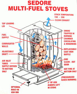

This is a very interesting stove -- burns just about anyting -- chunck wood; pellets; corn; wood chips (!). Far as I know, it has a pretty unique principle of operation. The long burn time and very low stack temperature look promising. It requires a good chimney draft though.
Water heating coils for DHW or hydronic heat can be installed as an option behind the baffle. "ask us" the website says.
