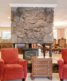

I’m in the process of making an offer on a house, and this place is cool in a 70s funky kind of way. Has anybody seen a totally open fireplace like this? Is something like this even safe and viable?
I saw photos of the house from 20 years ago, and at some point there was a wood-burning stove there, but it looks like this chimney was built as a real wood-burning fireplace. Then again I don’t really know anything about fireplaces.
Has anybody seen a design like this before?
I’m tempted to buy one of those double sided wood stoves and install it.

I have seen them and they rarely work

I'm guessing the reasons for this are fairly obvious, but would you mind elaborating on what the main reasons for this are, and if they can be updated or modified that would enable it to be a functional fireplace?

There typically is nowhere near enough volume in the flue for the volume of air allowed in by being open on 4 sides.

Thanks for the feedback. One more question if you don’t mind. You can see that a wood stove was installed at one point in the house's prior history. Do you think it would be viable to reinstall a new double sided wood stove?
I would hate to have this huge centerpiece fireplace that’s purely decorative.

if you can find a double-sided stove sure

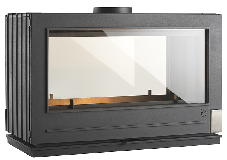

Supreme makes one. It has mixed reviews, with complaints about smoke spillage.
and some local commentary
There is also this stove, though I know nothing about it. Not sure where one would buy it, but it may be worth asking them.

I'm obviously total beginner when it comes to fireplaces, but I could in theory modify the existing fireplaces by walling off 2-3 sides to make it viable? I'll of course be consulting with local experts if/when I close on the house, but I'm hoping to have some kind of an idea of what I might be in for.
Anyone else have experience with an open indoor fireplace?

Not that open, but in my first house I had two “regular” open fireplaces. I was young and under the impression is was going to heat my house with open fireplaces.
Absolutely worthless for anything other than “hey that looks neat”
is your plan to heat? If it is, put a stove in it. If the plan is to just have it be pretty, I would put in a double sided gas fireplace of some kind

I love it. Who cares if it is practical, it looks cool. Maybe have some glass panels fabricated that could be attached to the verticals to maintain the look. Custom hinges to allow swing out on two sides for access and cleaning.
Slim fitting ankle high slacks seem to be back in style. Get a pair of those to wear around the house and you are good to go.

can't I go for hot AND pretty? :)
I think a double sided wood stove would actually be quite cool, although pretty expensive.
I'm totally going to be listening to Steely Dan on vinyl next to the fireplace, if I can get it working.

I think a round fire pit burner would look great with the crushed glass, if you have a functioning damper. Other option if you don’t want Gas is an alchohol burner. I arranged 3 smaller ones of this brand and was very happy for several years. https://www.ignisproducts.com/ethanol-fireplace-burners.html/. They claim vent free operation but I don’t think that’s a great idea. The burners are roughly 5,000 BTUs per foot of length. Ethanol is relatively expensive but my wood stove install cost me $5,000 and $500 buys a lot of ethanol.
I don’t like the look of the woodstove as much as the more open appearance if you decision is aesthetically motivated. If you want heat woodstove is the way to go. Personally I would pick design over double sided.

As a replacement, there are custom and retail efficient sealed alternatives that can give four sided views of the fire. But such an option may not be permitted in your area due to local regulations.
Simply as an example:

I like it, aesthetically. I'd find a free standing stove (if one will fit) and throw it in there, with a chimney liner and block off plate to keep the heat in the house. Dress up the view from the back with perhaps a painted piece of sheet metal and other hearth appropriate decor. I'd see this as attractive feature on a house. I'm sure many others would feel differently.
I recommended this to a neighbor with a similar fireplace (only open on two sides), tons of free wood, and two boys to help with the wood work. Instead, he installed a pellet stove in the basement that requires purchasing pellets from 30 miles away. They usually have one or two smokey fires in the open fireplace each season for ambiance, then remember that it's dirty, smokey, and sucks more heat out of the house through the draft than it replaces with the radiant heat of the fire. The boys sit inside and play "video games" and watch tic toc videos.
