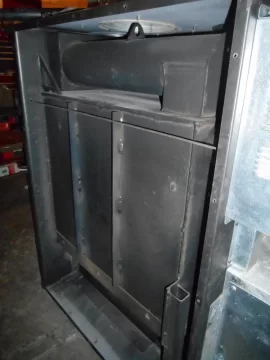

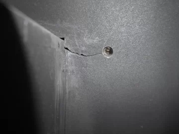

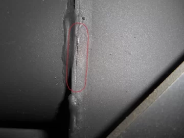

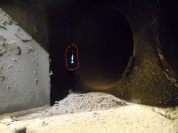

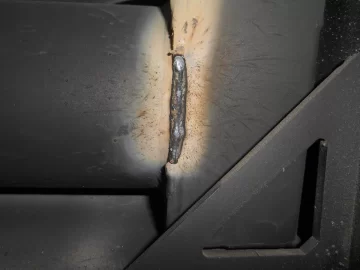

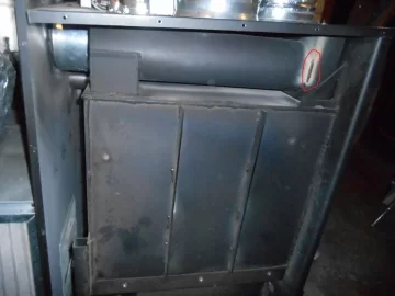

Well, time for an update of recent events.
I decided to take the insulation blanket out from behind the firebrick to try to get some heat off the firebox itself, especially the hot coals part of the burn cycle. I did this a couple weeks ago right before the real cold snap...big mistake. I hadn't considered the possibility that this lil experiment could backfire...but it did. The firebox temp was lower, still good secondary burn, but just not as hot as before...noticeably. I had to wait to warmer weather to let Tundra cool down so that I could heat with the lil stove upstairs during insulation re-install.
After I finished I decided to pull the side air jacket panels off to look around again in preparation for designing a top to install a plenum on. So I'm lookin all around the HEs to figure out how the air flows through this thing and I notice something...a crack! Well, not really a crack, more like a gap. When this thing was built the guy (gal) that welded the backside of the HE cleanout box to the side of the box just kinda missed with the welder, the weld just barely touched the back panel for a couple inches and the ultra thin weld didn't hold at all. Looks like it has been this way for a long time...likely from one of the first fires. I KNEW there was something wrong with this thing! As soon as I seen it I said "there it is!" This gap was enough that you could see light through so it was definitely flowing air.
This would cause problems two different ways.
1. The draft of the chimney would not draw as hard on the firebox because it was getting some of the draw satisfied here instead of pulling everything through the firebox. So the firebox is not gonna burn quite as hard.
2. The hot exhaust flowing though the HE cleanout box and the center HE would be cooled by the pressurized (+.2" WC) air from the blower since this gap was inside the air jacket. It also explains the very occasional wisp of smoke smell that I noticed too. Here's pics
[Hearth.com] Everything Drolet Tundra - Heatmax... Oh, I forgot. This is the one crack at the top right of the loading door that has grown here lately. I drilled it and will just fill the hole with furnace cement without welding to see if that alone will stop the crack.
[Hearth.com] Everything Drolet Tundra - Heatmax... The offender...
[Hearth.com] Everything Drolet Tundra - Heatmax... From the inside...see the light...
[Hearth.com] Everything Drolet Tundra - Heatmax...Post repair
[Hearth.com] Everything Drolet Tundra - Heatmax... A shot of the left side showing where this area is...and for anybody who has never seen a nekked Tundra...
[Hearth.com] Everything Drolet Tundra - Heatmax... The right side... just because
I fired up last night and it is hard to tell for sure how much difference this repair has made, but it did help, for sure. The duct temps seem to hold higher and for quite a bit longer. It wasn't that cold here today (low 30s) but the morning load managed to raise the house 3-4*...and that has never happened before!
I have never in my life had a reason to torch or weld in the house...and now this thing has caused me to do both, inside of a 6-8 week period no less! :mad: ;lol

Is the area around the H.E. door part of the firebox at that point? I don't think so because none of that area is even welded. To me if it was part of the firebox it would allow some smoke to come out.
You are correct, the HE cleanout box is about 3/8" or so above the actual firebox. So that crack is (as of now) just in the front panel of the furnace. And smoke shouldn't come out anyways (normally)...chimney has a negative pressure on the firebox
