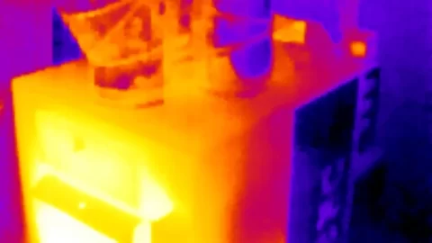

Just something interesting...I said before that the front of my Tundra seems to be where the heat is at...so I'm playing with my Christmas present tonight (thermal imaging camera) giving the house a scan when I walk by the Tundra. Visual proof of my previous statement, noticeably hotter toward the front. No wonder the front (3rd) duct runs ~10* hotter

You just now got to pointing that thing at your furnace? :)
I think I would have made a bee-line for it as soon as I got it out of the box. ;)
(Interesting stuff....)
Looking at that I'm really thinking it would benefit us all to really make a plenum for our furnaces. I knew the front ran hotter but this shows how much of an air dam that is in the front. It also have me wanting to look into how much time I would have into making a false front.

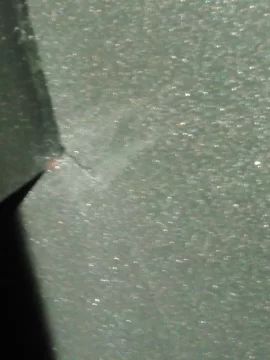

Looks like I need to keep an eye on the two corners below the H.E door. Almost 1/8" long on the right side and maybe 1/16" long on the left side. I'm afraid to say the word but it starts with a "C". ::P Still trying to figure out if its the paint or the steel. Now you know I'll keep you posted as things progress.<>
Is the area around the H.E. door part of the firebox at that point? I don't think so because none of that area is even welded. To me if it was part of the firebox it would allow some smoke to come out.
Mine is not welded around the heat exchanger door as well. I was wondering if that was something they were doing on the higher serial numbered units.
All I have are some tack welds along the bottom.
Can you see what i see? ;lol After scratching it this morning with a nail its safe to say that it is not the paint. Right side of H.E. opening. I think its safe to say that i have the newest model out of everyone on this site. " #1993 " I believe everyone on here gave SBI the benefit thinking things were finally figured out and cracking problem solved. Well here's your answer.

Yup, I's 'fraid of that.
I weren't gonna say anything yet, but at y'alls recommendation that these things don't heat well unless you run 'em hard...I been running the bag off of mine during this cold snap and I see that one of the existing "C"s has grown, despite the heat shield. I will drill it tomorrow, see if that stops it without welding...sorry to see that builder...gotta say though, I'm not too surprised with the temps you have been getting outta 'er...
Uh oh Houston. Crack indeed. Sorry to see that. I agree that bumping it off the high limit probably didn't help things, but that's still not good to see. I think the HX flange you asked about is welded on the inside, not outside, but would have to open the door to confirm.
