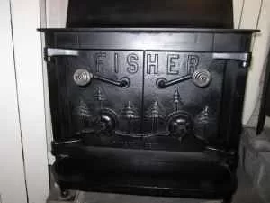

Hi to all!
Just found this very informative forum after doing some research to find out about the Fisher log stove I have in my house.
I'm located in Dorset, England, UK, so first of all, I was somewhat surprised to find out that the log burner (as we call them over here) is purely American born and bred. Does anyone know if these were distributed or sold in the UK? I bought the house in April of this year, but I believe the stove will have been installed back in 1990, when this part of the house was originally built. (The main part of the house goes back to early 1800's and still has the original range, plus another smaller log-burner.
So, to fire of a few newbie questions if I may:
1. Can someone please identify the model - I think it's probably a Grandma Bear from the pictures I've seen on here.
2. My model is fitted with a back-boiler, which I've not seen any mention of elsewhere. You can just see from the photo below that there are two large bore copper pipes coming out of the back, which feed up to my hot water tank upstairs. Were these fitted as standard or is it an after-market modification?
3. I cant seem to get my stove to burn slowly - it's using logs and/or coal at an alarming rate. The burner I had at my previous house could be closed right down to smoulder for hours - sometimes over a day or two without needing re-fueling. Even with both vents screwed right in, my Fisher still roars away.
4. You'll also see from the photo that I have an adjustable flap in the flue above the burner. I'm assuming is is only to block off the pipe when the burner is not in use to prevent down-draughts coming down.
5. In my general research on burners (I'm still a novice really), I found to my surprise that they burn wood best when at least 1" of ash is left on the base, but with coal, you have to elevate the coals off the floor of the burner. Are these statements true? How often should I be clearing out the ash?
I think that's probably enough for the time being. I confess that I haven't read all 10 pages of this thread as yet, but what I have read has been very informative. It's getting late here though and I wanted to register and post my questions before bed time.
Many thanks in advance for your advice and information.

Hi, welcome to the forum ! (I absolutely love my Land Rover by the way)
First you have a "Teddy Bear Fireplace Stove" there. (you mention closing "both" air dampers, so if only 1 damper was functional it would be a Goldilocks) Check out page 9 post #194 for more info on yours. They were available in two size stoves having 6 or 8 inch flues respectively. So you'll know if you have the large or small one by the size of the flue. (exit pipe)
2. The water coil was added. Not a factory option.
3. By closing both draft dampers, all Fisher Stoves should be air tight enough to glow with little to no flame. Obviously you have an air leak allowing air to get in somewhere. I'd suspect the inlet dampers are not closing fully? Smoke test with a cigar, pipe or.....if you light a match and shake it so it goes out, you may be able to hold it up to the intake while it smokes to see if the smoke is being pulled in through the intakes. Otherwise try it around the doors. If the triple door seal leaks, that has also been covered in the thread.
4. The thing in the pipe is called a damper. Dampers made in the US have a smaller metered hole in the center so after the stove is up to temperature, you can close it to control the draft
down to the metered opening in it. Not sure about yours. If it's solid, you would need to only close it part way. Always open it fully before opening doors to prevent smoke. Also it's used if you have a screen for your stove. That stove is designed as a free standing fireplace to be used with the door open and the screen in place. By closing the damper partially you can get some heat out of the stove without it all rushing up the chimney. Close it until smoke starts to roll in, and open it slightly just to prevent smoke from coming in. Only do this if you have the correct screen that came with the stove.
5. You are correct in leaving an inch of ash in the bottom of a wood stove. That is also what the Fisher Manual suggests. It slows the burn preventing oxygen from getting under the wood, and protects the fire brick bottom when loading. Ash only needs to be removed to make room for more wood. If allowed to get too deep, you'll find the fire area getting small. (if you light a piece of newspaper in the stove when you shovel it out, you'll find the fly ash is pulled into the stove keeping the house cleaner)
Coal requires air to come up through the coal bed. So coal is burned on a grate. They are usually movable to allow the ash to be shaken through with a handle. Coal stoves normally have an ash pan under the grate with air intake in the ash pan door to allow the air to enter up through the coal. European stoves use a "slicer knife" that is a flat bar that is worked across the flat grate like a knife slicing bread to break up the ash. It works quite well. Ash must be kept BELOW the grate since the air coming up through it cools the grate and keeps it from warping or melting the grate !
Fisher Stoves is still in business in New Zealand, so you may be able to get a new one near you. They are not available to us in the US. Yes, it crossed my mind to have you buy one and ship it to me. But I'm afraid my wife would get the Rover in the battle that would create.
What a fantastic reply - many thanks Coaly! Thanks too for your appreciation of good old British automotive engineering - shame we dont have a motor industry to call our own any more. The Land Rover is timeless and a classic - I followed one home last night as it happened, which was over 25 years old and still pulling like a horse. They're very popular still around my part of the country.
Thanks for the pointer on my "Teddy Bear" stove - sadly the ebay link has been died, so no information there, but at least I know what I'm looking for now. I'm pretty sure my flue is 8".
Strange that the water coil was added - it looks fully integrated. There's a box at the back of the chamber inside that I assume houses the coil. It certainly works though and provides loads of hot water upstairs.
I'll be sure to test the air-tight seal on my stove as I'm pretty sure there must be a leak somewhere. I did read the earlier posts about gaskets and other methods of sealing, pro's & con's etc., so I'm clued up on that now.
Thanks for clearing up the damper - I wasn't sure whether it would be safe to close this off when the fire's going, but perhaps that will help slow down the burn. I guess it's all about learning the process that works best for your particular installation and the fuels you use.
Great trick about sucking on the fly ash by lighting a newspaper in there - I cant believe how much dust the thing generates when cleaning out.
Which fuel do you think is better then - wood or coal? We have been using some compacted, pre-formed coal briquettes that seem to burn quiet well, but they do produce a lot of ash. We dont have a grate in our burner, so perhaps we shouldn't be using them really.
I haven't seen any evidence that Fisher Stoves are still available in the UK - not even second-hand. My one seems in pretty good nick though, so I'm content to learn to live with it and enjoy the warmth it provides (and hot water!).

I should have made it more clear that the stove pipe damper is mainly used to control the draft. A good drafting chimney would need to be operated closed more. A poor drafting chimney may not need to be closed off much at all. Depends on height, out door temperature, lots of factors. (the colder outside, the stronger the draft, the more you close it. Barometric pressure changes the setting as well). No one can tell you where to set it until you get used to it)
The back of some pedestal stoves have steel plate heat shields for reduced clearance to walls. The manual gives the minimum clearance to combustible wall. Most if not all are 12 inches, but the manual should be consulted for your actual installation. This places the stove pipe closer to the wall as well, (14 1/2 inches) so double wall connecting pipe must also be used for reduced clearance. There is a picture of the shields at bottom of page 6. That may be what you're looking at. It's a simple matter to add a copper coil between these shields.
Yes we use stove top fans. They are usually powered by a thermocouple type power source (dissimilar metals make contact when hot creating a controlled electrolysis that becomes a generator to run the small electric motor). You can look up Ecofan as one brand. The Sterling Engine was used over here in the 1800's as a large engine in the basement to pump water. A coal fire was built in the base, and the hot air engine would stay running after a push, and was connected to a plunger rod going down in a shallow well next to the engine. I repair and run steam traction engines and antique engines like this, so most people here are not familiar with that type of engine. The electric stove top fans only have the motor shaft that turns with nothing to wear out but a bearing.
