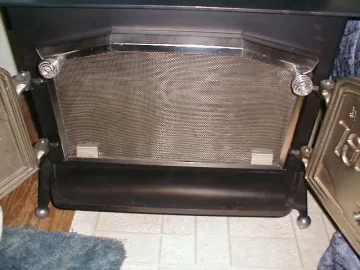

Picked up my brand new XL at the ABE (Allentown Bethlehem Easton) Airport finally !
First surprise is the removable ash shelf. You can see the two holes drilled through the leg fronts that it installs through.
The screen and frame is all stainless. Doors and handles are nickle plated inside and out.

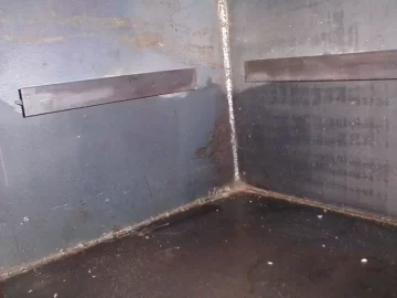

Second surprise is a second row of firebrick above the first. Instead of angle iron welded to the side sheets, flat iron welded into a T is used to hold the top of the bricks on the bottom level. This T forms a shelf for the second row of fire brick to be placed above the first. The bricks fit upright as normally installed.
No smoke baffle since this is pre 1980.
The first picture shows the T iron. The second shows the angle iron to hold the top of the second course of brick. The wet looking discoloration of side sheet at bottom is due to cleaning with WD-40. I'll be using MAAS metal polish on the inside to remove the light surface rust that has started on the inside of the unpainted steel plate.
