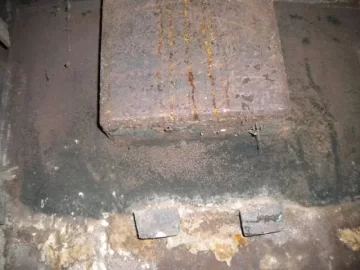

Hi, new here to the forums, I have a Fisher, I'm guessing from what I have read is a grandma? Any way it came with the house when I bought it and having used wood stoves growing up I figured it out. I have now realized there is a good sized store of mixed coal in my mom's basement... seeing as the manual found elsewhere on this site does say coal is an option, if i use a cast grate and coal as a supplemental mix to the wood I am hoping for a full night burn to at least give me hot coals for the wood again in the AM. Here are a few shots of the stove, maybe one of you afficanados can give me the details on it?
Thanks, Sean
[Hearth.com] Everything Fisher
Reactions: Todd67
Welcome to the forum; A pre 1980 Grandma.
Fisher sold a coal grate accessory. They didn't work well, and it's sales never took off.
You can elevate the coal on a grate to try to burn it, but don't expect much. You have to keep all the ash from under it, so it gets air up through the grate. The larger the coal pieces, the more air between the pieces and the better you will do. A stove is designed for burning wood in an inch of ash on the bottom, or coal suspended on a grate. It's not a coal stove. If you can achieve the critical high temps to ignite the coal, once the glowing mass cools below that ignition temperature, you're not getting the fire back. You will be shoveling out a mess.
If you could build a grate system that contacts the doors when shut, and be over the air intakes, so all the air comes in below the coal, reduce the outlet to 6 inch, you'll have a coal stove. A good coal stove would have an ash pan on the bottom for easy cleaning. You couldn't burn it with doors open, since all the air wouldn't be directed through the coal.
Coal needs to be on a grate with the air coming from underneath. As in the oxygen has to come up through the coal bed. Rising hot gasses from combustion going up the chimney is what pulls the air through an air intake, normally under the fire, where the ash pan is, and up through the coal. Coal expels a flammable gas as it heats up. A secondary air source is needed above the fire to mix oxygen with the coal gas to allow it to ignite and burn with blue flames on top of the coal bed. Otherwise this gas is wasted.
Fisher also made a "Coal Bear" that was a tall furnace type stove more for basements. They must have been tested with Bituminous soft coal, because they burned poorly with Anthracite hard coal.
Below is the Coal Bear; Notice the two primary air intakes on the ash pan door below the grate, and the single secondary intake in the loading door above the grate for secondary coal gas burn.

Thanks, your post was so well worded it taught me more about burning coal then all weekend on the internet. I have a grate and I'll see what I can make it do.
