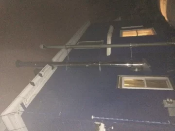

Exterior chimneys will be colder, but this sounds a bit extreme. Can you count up the 3 ft lengths and tell us how tall the outside chimney is? That will help with figuring out what is happening. Modern stoves need a lot more draft to pull out the smoke. Draft is the engine of the fire. It sounds like this stove's draft may be weak. What floor of the house is the stove located on?

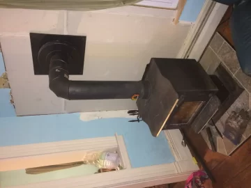

I just counted and I have 6 sticks (3ft). The stove is located on our main floor, I have a basement, and an upstairs. I am trying to attach photos I just took so I apologize about the one of the chimney outside.

Exterior chimneys can be balky. The two 90 degree turns are reducing the effective drat. Still, it should draft reasonably once warmed up. Have you tried top down lighting of the fire?

whats up with the other chimney? is that a gas flue? does it stay running all the time? Its below the height of the woodstove flue but if its warm it could be competing and if it draws enough winning.

From what the OP wrote this sounds like a constant issue, has to warm the pipe just to get the fire going and reverses after the fire burns down. From the picture that chimney doesn't look more than 13-14' to me.
The piping beside the chimney is for my gas furnace and hot water tank, the chimney total height is 19' 9" and sits roughly 5' above the other pipe, sorry angle of pic gives a weird illusion.

Well you could take that 90 out and try two 45's coming off the stove. I'm not sure it would be enough to solve the problem though..but it could help.
Well you could take that 90 out and try to 45's coming off the stove. I'm not sure it would be enough to solve the problem though..but it could help.
Is there a slight rise on the horizontal pipe going into the flue?
I have tried a slight crack and only sometimes does it work, depends if any part is warm or if it's completely cool.
And yes a very very slight rise, could that actually disrupt that much. It's at most maybe 1/4".
You want the rise and a 1/4" is ok i guess..a little more would not hurt.
Ok, so now my question is. To put more rise into the pipe id have to cut down my long pipe coming out of the stove. Is there any specific way I should do that so the slow will go into it?
Well if I were you and if I was going to do that I would get 2 45's and go from there.
