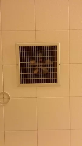

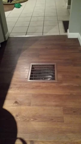

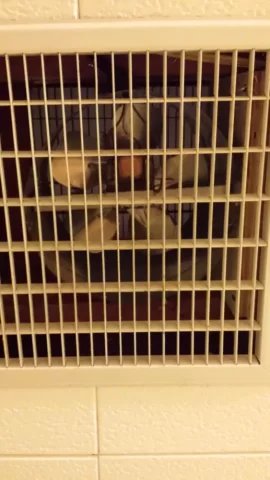

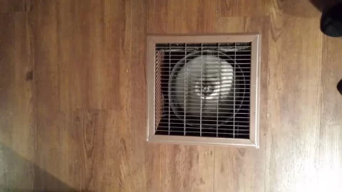

This fan was the game changer for me! Now when you come up my stairs from the basement it almost seems windy from the circulation.

Basically just an in line fan. I don't think it will matter to much where your stairs are in relation, in fact maybe farther the better so it distributes the air more? Hardware stores should have them in stock.
