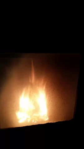

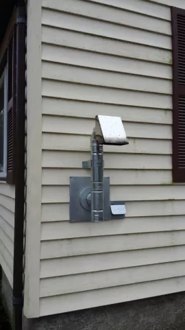

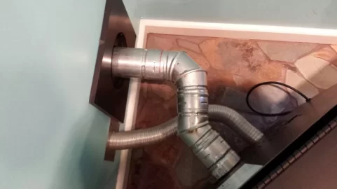

I've been doing a lot of reading on what other users are saying about their vent being just warm to the touch. Mine is very hot inside and outside of the house; I can hold my hand 2 feet above the vertical rise outside for less than a second before I would probably burn the skin. I have bent the tabs in on my impingement plate so it sits even closer to the back wall and has maybe an 1/8 of an inch of forward lean. My vent is double wall Duravent 3" and I never imagined it would be hot enough to leave a nice burn on my arm when I grazed the elbow when I was finishing the grout on the stone. My settings are 4-2-1 and mostly burn at 1 and 4 or 3 and 7 for when it gets below 10 degrees. Besides the daily cleaning, I have gone through the stove and cleaned it out thoroughly....4 times.... with a 3/4" silicone tubing attachment i made for the vac. The house is only 1200 sf and I am not having too much trouble keeping it up to temperature. It almost seems the air coming out of the vent is as hot as the air coming from the blower and from my understanding this doesn't seem anywhere near normal???
I attached some pictures of the venting and of the flame that does not look to be too lazy. I know dirty glass.

You have a leak in the elbow behind the stove. Couple wraps of self fusing silicone tape will cure that. Some stoves have a higher exhaust temps. To get a true read of the venting temp you need to use a non contact temperature. They don't like reflective surfaces so a touch or two of flat black stove paint is in order. Things can feel hot to touch at a little over 110F especially metal.
Yeah I keep forgetting to grab a heat gun from work to check it out. It's pouring outside right now but the termination cap and vent are both dry because the rain vaporizes instantly when it touches the metal. I'm no Marine Biologist but something tells me that metal is closer to the 212+ range
human skins burns at about 140ish....be careful
Above the vent will be very hot. The exhaust hood will be very hot. Don't touch.
The vent walls should not be very hot. If the outside of the vent is running hot enough to burn you, it is possible that you are over-firing the stove. I have seen pictures of a vent glowing red from an over-fired pellet stove.
If you have significant leaks at the joints in the vent, that can cause the outside of the vent to get much hotter than it should be. I wrapped all of the seams (including the elbow's joints) with a high temperature aluminum tape. If you have leaks you can probably smell wood smoke when the stove starts up.
Thanks by the way about the leak suggestion. Those 2 leaks are coming from where the elbows can be rotated, not the joints. I would not call the leaks significant because during start up there is no odor of the pellets which i did experience when the stove adapter's silicone was pulled from the stove. I even went as far as to get a 4 gas meter with an integrated sampling pump from work that measures CO and there was nothing registered. In my opinion, burning on the lowest setting no matter the duration, should not over-fire the stove.
To be honest I think there is heat escaping from somewhere within the stove that it shouldn't. Common sense would point to the impingement plate but I cant get that sucker any tighter to the wall and I saw in a previous post Mike from ESW said there should be a little play.

I found a cheap meat thermometer in the house and I placed it out on the termination (not touching any surface) and estimated it to be about 240 degrees because it tops off at 190. The inside blower is reading 145. This is on the lowest setting possible, so I think this proves shes burning a bit odd.
