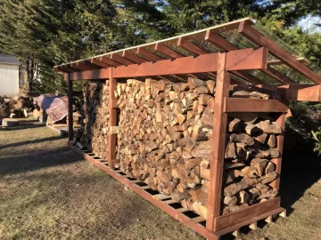

Hey Everyone.
Looking for a little guidance to prep for next year. White/red oak is reading about 21%-22% right now. Do you think this will be ready for next season? Everyone around here sells cords that have only been split for about 1 year, so I just want to get my head straight if I need to start searching for dry wood.
Any insight from the folks here who season a lot of oak would be really appreciated.
Thanks again!

I had white oak on pallets, two 5x6' rows with a top cover tarp and it was pretty solidly 18-20% after 18 months (two summers). The wood was mostly smaller on the ~2lb side though. That shed looks like it will season nicely.

Great shed by the way. Every month of May , I am splitting wood for the future seasons. I need more space to store in a cover area , I want to have always 3 to 4 cords drying in the full sun. I will build this style of shed as soon as the snow is gone. I can see it is made up of 2x4 and 4x4, won't take long to put this together .
