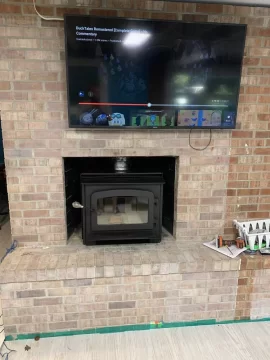

Not a great place for your TV as heat destroys electronics. Just saying.

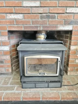

I also enjoy the no surround look I just wish the chimney connector pipe was black. It's kind of an eyesore being metallic colored. Wife said she would keep ot this way if the pipe were black. I thought about painting it but I'm not sure how well that would hold up.

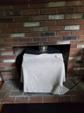

Don't see much big galoute slobber on there.

Ahh yes that's because I have it covered up 24/7 for dog protection. I took the towel off for the pic lol.
What do you guys think about spray painting the liner pipe with the same stove spray paint I use on the stove?
Just get a piece of 8" snap together pipe cut it to length and put it around that 6"

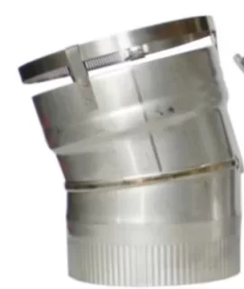

Looks like the flue connection would be cleaner and better seated with a 15º elbow.
I’ve got my piece of 8” but haven’t put it up yet. I need to drill it for the damper and maybe extend the damper rod.
Good idea. I might have to cut a but of the top/back away so it'll sit flush but that's easy. You wouldn't see it anyways. It could just rest on the jacket, right? I don't see any issues with that.
Probably. If I ever have any reason to disconnect I'll swap it out. When the stove was installed I was true stove greenhorn so I just went along with what the installers and inspectors said. I had it looked at recently by my sweep when he did my end of year and it was solid so I'm going to leave it be for now.
I'm in exactly the same boat. One day I'll put the black pipe around the adapter and replace my straight adapter with the 15° joint. I didn't even know they were available when I installed the insert.
