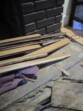

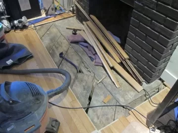

We cut out the hardwood today. Please see the attached pictures.

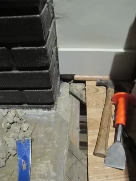

Here is the issue I see now: when they poured the slab, the concrete, in the area directly in front of the the fireplace, has oozed over the wooden joists that frame the slab (please see picture 2). So we cannot butt up the Micore directly to the slab all around. There will be a small area (unfortunately right in front of the insert) where there is wood only covered by a an inch of concrete. My husband thinks that it would not be a problem because if the slab gets heated up, it distributes the heat within itself, so no one area of the slab would get very hot. Plus, he says if the area where the concrete oozes were an issue, then we'd have that issue all around the transition from the slab to the Micore-protected area, because the slab is framed in wood about an inch below the surface (the slab as a whole is 10" thick, but there is wood framing around it - I had a picture of it from below earlier in this thread).
If this transition (and especially the area where the concrete has oozed over the wood) is indeed a problem, the only solution would be to lay the Micore all over the hearth, even the concrete slab. With the concrete backerboard that has to go over that, this strategy would raise the whole hearth 1" higher than we had planned. We are trying to keep the hearth low (and were going to tile directly over the concrete slab), but now I'm debating if we will have a fire safety issue because of the transition between the slab and the Micore-protected area beyond.
I hope what I wrote is not too confusing... I would be very grateful for your thoughts!

Take a flat faced, cold chisel and clean up the edge. Just chip away the cement ooze. Wear googles, it will come off quickly. Then patch in that hole with a triangle shaped board or piece of plywood that matches the subfloor thickness. Not a big deal, this is a one hour job and you are back on track.
Thank you, BeGreen. We did what you suggested. It was actually easy (I wonder why in 1924 they didn't do that, and instead cut those planks short??).
So do you think that if we lay the Micore only over the wooden subfloor butting it up to the slab as planned, the transition will not be a problem (as a "heat leak" that might jeopardize the framing)?
Yes, just try for a snug fit with the micore. The pictures make a world of difference to see what you are doing. Now that I see it, I better understand why you were asking about the thinset.

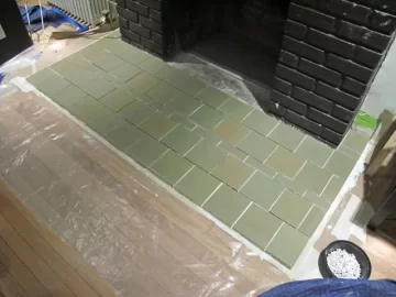

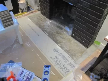

We have finished the hearth extension and installed the tile. Grouting is tomorrow, but I wanted to post some pictures of our progress. The extended area to the front is built as follows:
- sheetmetal (aluminum flashing) over the wooden plank subfloor, thinset underneath it
- 1/2" Micore 300
- 1/2" Durock laminated onto the Micore with thinset. Everything then screwed down with 2 1/4" Rock-On screws.
We used TEC Superflex thinset to laminate the subfloor sandwich, and to lay the tiles.
We used sand mix mortar to repair the firebox floor, and extend the hearth to the sides.
We also added some cross-bracing to the floor joists below, to minimize any flexing.
We have an expansion joint between the tiles over the concrete slab and the tiles over the Durock/Micore sandwich, which is going to be caulked. The concrete slab was slightly lower than the Durock area, and we tried to even that out by backbuttering the tiles over the slab. Overall, we didn't achieve a completely plane surface (the uneveness of the substrate in conjunction with the slight crookedness of the 'artisanal' tile we had chosen was a bit too much of a challenge for our first tile job!), but we'll view this as adding to the charme of the hearth! :P
The tiled hearth extension is now about 1/2" higher than the firebox floor. We are wondering if we can set the insert onto 1/2" inch of Durock, to raise it to the height of the hearth extension. If it's non-combustible, it should be fine under the insert, I would think. Has anybody done this?

Yes, you can use a sheet of durock under the insert. I like to cover it with sheetmetal because it makes it easier to slide the insert in/out on the metal than on the raw cement board.
