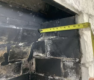

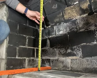

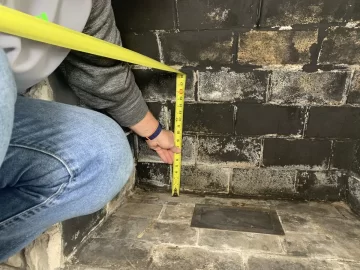

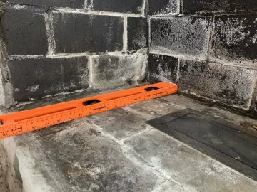

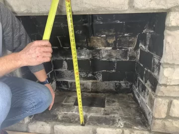

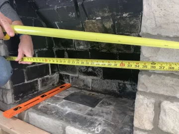

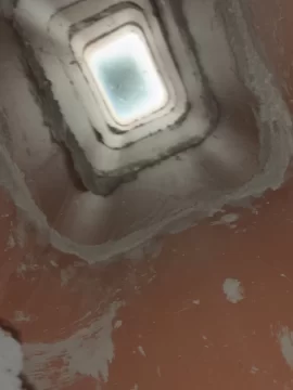

I’ve found an insert that will fit in the current firebox https://www.regency-fire.com/en/Products/Wood/Wood-Inserts/I1500 but it says the min depth is 13-3/4” and my firebox is 15” at it’s shallowest based on the height of this one. Can I not just use metal studs to go up against the brick (if I remove the stone) and then only the surround would be outside the firebox? Doing it this way would only extend the fireplace 2” with metal studs surrounding the insert. Then I could possibly use some metal trim to hide the gap of the surround to the fireplace stone exterior.
I’m already at a point of no return. Here’s some pics with a picture of the chimney.

I was searching the forum and read a thread where someone removed the back bricks to increase the depth. Behind the stone veneer on the interior fireplace is bricks but on the outside of the home the chimney is made of cinderblocks. Is this something I could do then just reface the the fireplace with a stone veneer I think looks better?

I was searching the forum and read a thread where someone removed the back bricks to increase the depth. Behind the stone veneer on the interior fireplace is bricks but on the outside of the home the chimney is made of cinderblocks. Could I also remove do this?
Yes you could

I had the top two rows of firebrick in the back of my firebox removed so my insert would fit. The damper will most likely have to be removed as well.
