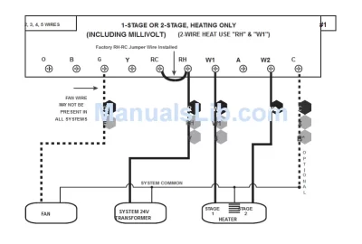

I want to connect an external thermostat (I'm thinking this one) but I have some questions...
The manual for my stove doesn't give much guidance other than "connect the thermostat according the the manufacturer's directions". There's two screw terminals in the back that I would connect the wire to, but then what terminals am I connecting those two wires to?
Thanks in advance for the help. :)
your only going to use 2 wires from Tstat so they go 1 to 1. you new Tstat will have the hook up guide with it
But to to which two terminals in the thermostat am I connecting the two wires coming from the stove? This is the diagram for the "2, 3, 4, 5" wire setup. Am I correct that the two wires from the stove will connect to RH and W1? And do I leave the RH to RC jumper or remove it?

yes RH & W1
Jumper on the stove no, thermostat yes

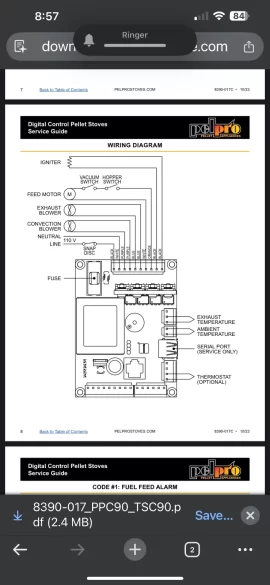

Looking for more information on hooking up a external thermostat on a tsc90, I know there's a connection on the back of the stove but there's no wiring attached to the inside of the stove. Owners manual isn't any help
