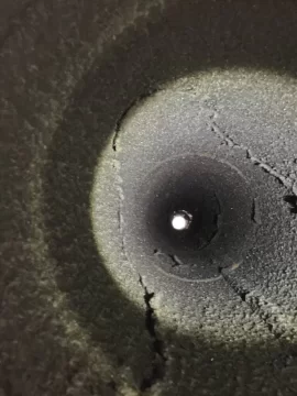

today i'm cleaning the flue for the first time.
wasn't bad at all on the top of the inside...
[Hearth.com] F500 v3, Don't be James
...and looking up before i start with the sooteater...

The build up looks good. Well done.
The ash on the cat could be due to too much draft; it can suck up fly ash.
How tall is the chimney, from stove top to cap?

Thank you!
Not sure but I’ll measure tomorrow and let you know…
Now it seems it’s back to normal
Reactions: JamesGuido
ok. not likely too much draft then.
