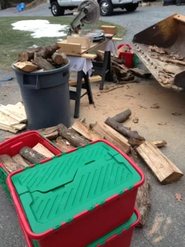

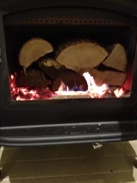

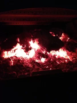

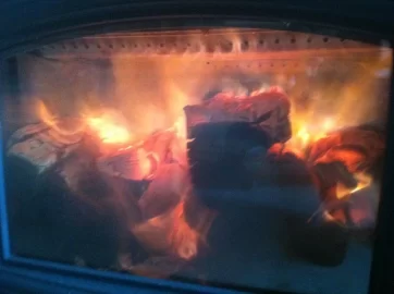

I loaded up last night with 6 splits N/S and 1 split E/W on top. Burned about 6 hours before coaling with the stove top temp of 275. Best run so far.I pulled out my beater chop saw and cut to fit for N/S loading. The back of the stove is stepped. Going to try loading tighter tonight. [Hearth.com] F55 Overnight Burns
275 after the 6 hours or during the burn?
Nice. What kind of wood are you burning?
This batch looks to be mostly maple. 7 splits loaded up for the night. [Hearth.com] F55 Overnight Burns

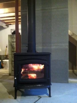

You're gonna love it once you figure out how to run it. That big front glass makes for great viewing. I'm going to put mine up another foot or so on blocks for easier loading and better viewing.
