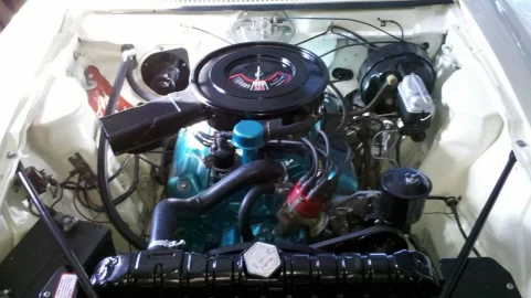

The name 343amc comes from my "Summer Toy". I have a 1969 AMC Javelin that has a 343 V8. I bought it in 1996 when I still turned wrenches for a living, stripped it down as far as I could go with a unibody car, including the dead cats that were in the trunk (true story), and its been a work in progress since. It's kinda fun being the odd man out driving a piece of Kenosha muscle amidst the seas of Camaros, Mustangs and Chargers. :)

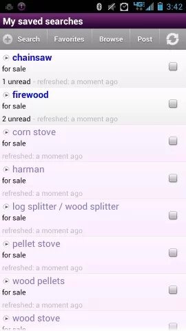

As far as the Craigslist app I use, it's called c Mobile Craigslist Client for the iPhone. I paid 99 cents for it to get rid of the damn ads. I think saving a search required the paid app as well.
The Craiglist app I have can save searches, (free also) but is no longer available. :(
Its called Craiglist Notifier. I can save a search, with my keywords, and for several locations. So anytime something with the word "Pellet stove" gets posted in my 3 selected areas, I am "Notified" immediately :)
I get a lot of notifications, so I only check them a few times a day.
(Here is a screenshot of what my screen looks like, and all my keywords) :(

Thanks. Trust me when I say that there are things you can't see in the pictures that I see in real life that aren't all that great. Especially on the cold air return.
