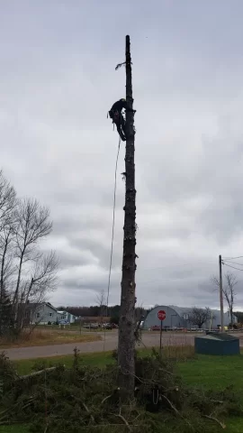

  • [Hearth.com] Falling a large rotting pine
Reactions: GadDummit
