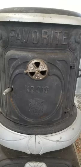

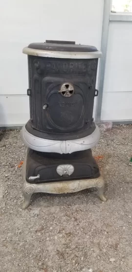

Hello all,

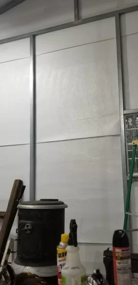

I'm new to woodburning stoves and have been reading a lot of posts. Great information but i do have a few questions. I bought a Favorite No.019 stove. I believe it is called a cylinder stove instead of potbelly. I cannot find and information about the stove, not even a photo on the interweb. Is it a good stove to heat my workshop? Shop is a metal carport style with bubble insulation. I understand the distances and heat shielding requirements.

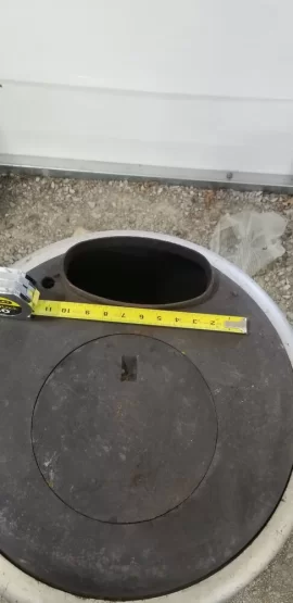

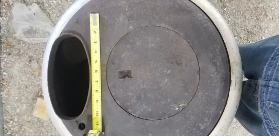

The stove exhaust is an oval 8 3/4"x 4 1/2". I think it is the same circumference as a 7" pipe.
Can i just oval a 7" pipe if it fits and reduce to 6"?
Go through roof or out wall?
Whats the preferred "kit" to get out of building?

Yes, many of these stoves just used an ovalized section of pipe for a starter .
I'm wondering if this is a coal stove. Does the ashpan door have an air intake on it? Is there a shaker grate inside?
Yes the ashpan door does have an air intake. Does that mean something? Does it indicate a coal stove? The only grate was broken but appeared to have small feet to hold it about 1 inch off the bottom and could be removed through the ash door. I just finished making welding a new grate to put in it and I am making a scraper to pull the ash out.
As I said, I cannot find any information about this stove. Does the No. 019 mean something or is it just a model #??
