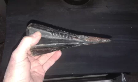

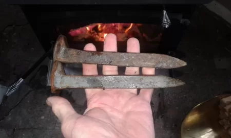

[Hearth.com] Favourite Wedges... The only wedge I have ever bought is this grenade style one. It has split open everything I have ever thrown at it with less effort than a regular triangle shape one. I don't actually own any regular ones, I have always used railway spikes that I find on the old abandoned spur line out back of the property. [Hearth.com] Favourite Wedges...
I have a couple of those grenade wedges and they've been fantastic. I have a couple of regular wedges too but they kept popping out. Now the only time I use them is to widen an ornery split when the two grenades are already fully embedded.
I have the grenade also and agree that it is superior to the standard steel triangle wedge. Wonder if anyone here has ever used one the the high end wedges you see online e.g. gransfor

For standard wedges make a small plunge cut 2-3 in's deep...they won't pop out.

My grenade wedge is deaply embedded in a log at the bottom of my pile of wood... hopefully I will be able to find it back, take it out and stack those log this spring

Yeah, that makes sense, but it's an extra step and I usually don't have my saw around when I'm splitting anyway. I guess I could make a plunge cut when I'm bucking but I don't necessarily know which rounds are going to need a wedge until I try splitting them. It's a lot easier to just use grenade wedges!

Back when I split mostly by hand...that hurts thinking about it...lol...I was cutting a lot of mature oak...after they were bucked I would immediately plunge cut them and then grab a sledge or maul to wrap up...got pretty good at. I hated grenade wedges as I had more trouble with them vs standard wedges..matters not now as I don't use either.
