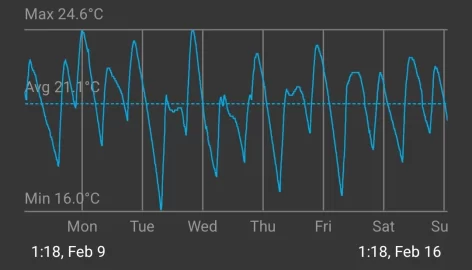

I didn't feel that the Jotul was working hard - once it was up to temperature and all the wood was burning well I'd dampen it all the way down and it would produce plenty of heat, always increasing the temperature in the house. Unfortunately that burn time was limited and it wouldn't release much heat when down to just coals. My thermometer nicely shows the on/off nature of its heat production.
