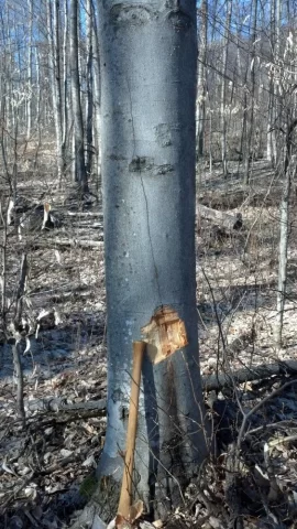

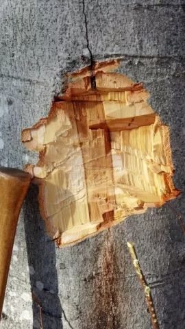

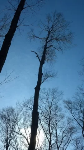

Some pictures...
With the rain, discoloration near the crack was obscured. Took a few more chunks out. The crack runs along the right side if the discoloration. If the location where I checked the crack is at 12 o'clock, on the tree, the two alleys where I could easily drop this are at 1 and 3 o'clock. The foliage is asymmetrical and centered along the slight lean at 2 o'clock. I'd need to drop this at most 30 degrees away from where it wants to drop... Easy! Total height of crack, about 5 feet. Trunk diameter, probably closer to 16" after closer measurement. If this weren't split, it feels like a crazy simple job. With the split... I've never dealt with one, so I don't know.
The tree is showing some buds, but I can't see it living past this summer based on its state last fall. I'd love to get this before it's dead, but as I and others have hinted, I don't want to risk my life over it. Birds and bugs need homes and there are many trees in the woods.

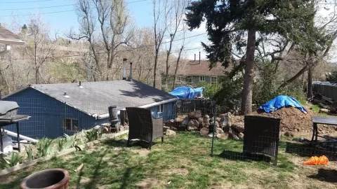

we dropped this one the other day... had a 45º turn from where it was leaning, and had to avoid the house and power lines....
[Hearth.com] felling a beech with a split in trunk
we ended up dropping it about 2 feet above the timber at the bottom.
Reactions: D8Chumley
Wow that's a scary one.
yeah it was. we ended up limbing it off as best we could with the pole pruner, then tied a rope to it to pull, and another anchored to the truck in case it wanted to go backwards. we ended up pulling it with 2 of us, and it went perfectly! (then the saw died as i was bucking it up)
Some pictures...

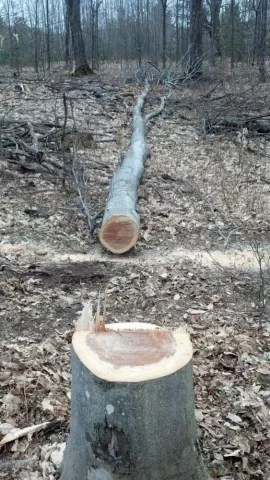

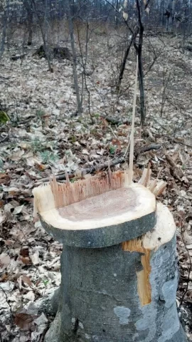

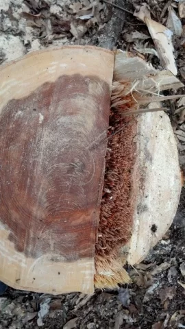

I took it down today. Pretty much like clockwork!
In the pics, there is a twig on the stump that aligns with the radial crack. It came to within an inch or two of the center, then propagated tangentially (saw dust filled crescent.) Note the baby-barber-chairing on the far side of the hinge behind the crack. The portion on the log side of the cut was quite long. If the crack had been parallel to the hinge, I would have left the tree standing which would have been fortunate; my guess is it would have been ugly.
[Hearth.com] felling a beech with a split in trunk [Hearth.com] felling a beech with a split in trunk [Hearth.com] felling a beech with a split in trunk
There ya go.:)
