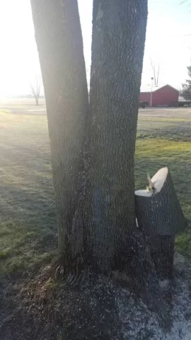

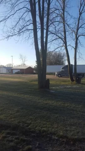

So I've got a question on taking down this tree. It's an ash the eab got into and needs to come down and it's far enough in the open that I can work with it and I practice.
Now I don't think where the trunks Y there is enough force holding thek together to wedge one side and then make my felling cut on back side and bring both trunks down as 1 unit correct?
My plan was to start on the right side and put my wedge cut about 50% through to start. Then work it in a little more until I'm about 75-80%. Then make a vertical cut down the middle of the 2 trunks and will that release enough hold that it will come down?
Or do I need to bring a platform of some sort out to get up high enough that I can do a traditional felling cut from the back side? Got to get about 6 feet off the ground (2 more than is comfortable for me) to be able to angle the bar correctly.

By experience, that ash should be notched as two separate trees. By the pictures from the crotch, to almost the ground line, there is included bark. In other words, in the end when you cut the trunk at the ground line there will most likely be a Crack from the crotch to the ground. So if you notch that as one tree , when you make the back cut the tree may separate and fall in two different directions.

I agree... I would take two separate logs from that then work on the trunk with much less pressure on it. It's easier to control where each log falls that way, and is much safer as well..imo.
I think you should do a traditional notch in front with a back cut, even if that means getting up off the ground. Or here is another approach to consider Cut a notch in the face of one tree so that the tree will fall away from the second trunk. Then plunge cut about an inch behind the notch and cut back toward the second tree. When you have cut through the trunk of the one you are felling, it will fall normally, I think. I think the connection between the two trees is weak enough that it won't make much difference except that it gets in the way of you and the saw. It won't hold the tree up significantly.
Yes to your second approach but additionally I would zip my saw down the seam between the two trees to be sure that they are fully and freely separate from each other. You probably are right that they will easily separate but probably doesn't cut it. I'd much prefer to be absolutely sure.

I think Paul Bunion has a good idea. Separate the trunks with a cut, then fell the first tree as I described. A friend recently turned me on to plunge cutting the back cut. It is nice because the last bit of wood on the outside of the back cut *normally the first wood you'd cut) remains in place and keeps the tree securely standing until you are ready to fell it. You won't the start the plunge cut in the middle of the trunk then cut forward, toward the notch, to form a hinge the way you'd like it to be. Then resume cutting back toward the side of the tree far from the notch.

Yes, bore or plunge cut is what I use 90% of the time when the trees are big enough. I would drop them as two seperate trees, but be careful and have a spotter. Watch for widow makers and the second trunk moving when the first is dropped.
I noticed the angled back cut on the stump next to your trees. If you made that cut be very careful doing it in the future. You want your back cut to be horizontal approx 1" above the bottom of your conventional face cut.
Cutting down at an angle can create a "ski slope" as the tree slides down the back cut, causing it to fall the wrong direction.

I agree with most. I would first notch the heavy leaner on the left away from the other trunk, as it appears to want to fall in that direction. Then unzip them. Depending on how much wood is left after separation, notching the left one afterwards could be tricky. That being said, separating them with a notch in the leaner could cause it to fall once free. Be careful. Once they are separate, with a notch in place, plunge cut, then release cut. Good PPE is a must. EAB ash trees are notorious limb droppers.
