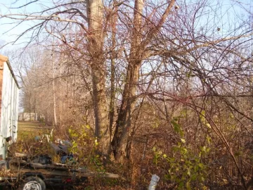

How do you go about felling a tree like in the pic , when there is no room to get the saw in, and make a
back cut ??

Looks like tons of room for back cuts there. Even if both are leaning the same way, you should be able to make your notch at an angle to the lean and leave room for the back cut. Obviously, cut the one on the lean side first.

Notch & careful plunge cut & you shouldn't even touch the adjacent tree.

We can't see the whole tree but what we can see it does not look like much lean there. Cutting it at about the 3' level gives plenty of room and no plunge cut is needed.

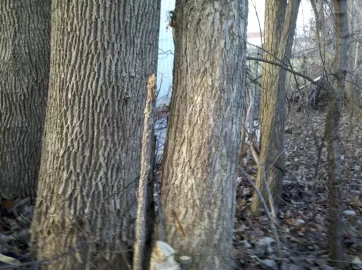

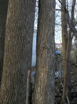

The gap between the trees in the center of the pic is the one I am asking about, and I measured the gap, and it is 2 3/4in, so there is not room to do a regular straight in back cut on that tree.
Another pic , and the second pic is the same trees but , the one in question can not be seen in the second pic

I would plunge cut it carefully because in my opinion you have better control over where and when it falls. But then I love plunge cuts ;). That said it does look like it could be dropped from the back easily enough though.

There is room for a back cut there. There is nothing that says you have to do the back cut in between the trees. Put the notch where you can reach the back cut. Unless I'm missing something, that is the easiest way to go and what I would do. A plunge cut would work too, but would be more work and take longer.
I'm not going to explain it but, I see now, how there is room fore the back cut

There isn't much lean on that particular tree

Take one at a time starting with the one on the far right. The one on the far left I would want a bull line in as well.
