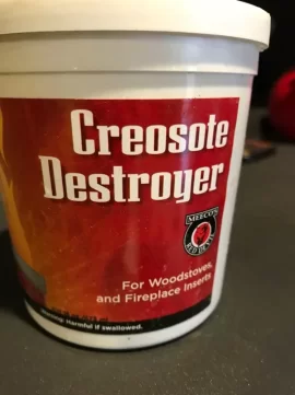

I can’t say that this works for sure but I do burn a product in my stove that may or may not help. I lean toward the fact it helps but I have no proof and wouldn’t bet my life on it. I can send a picture of the container when I get home.

Finally made it back to posting that pic. This is the stuff I have used. I don’t follow the direction on usage, recommended every 3 burn. I use it about once a month, I had almost no build up last year. Can’t say if this helped or not.
